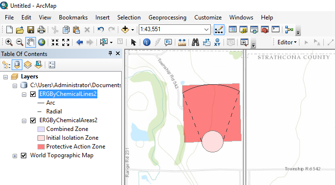

3. In ArcMap 10.4, I accessed the ERG Tools toolbox inside of the "capability/toolboxes" folder of the contents (it is a Python toolbox), and ran the "ERG By Chemical" script tool...

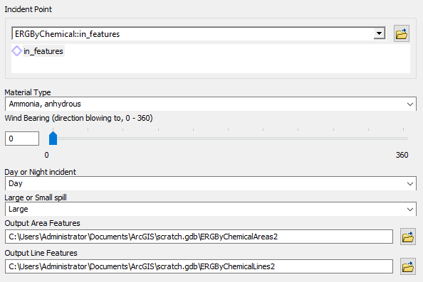

The ArcMap data frame has no contents except for an ArcGIS Online basemap...  The tool requires several parameters:
  • Incident point - I clicked on the map to create a point
  • All other parameters, I used the default values (see graphic below)

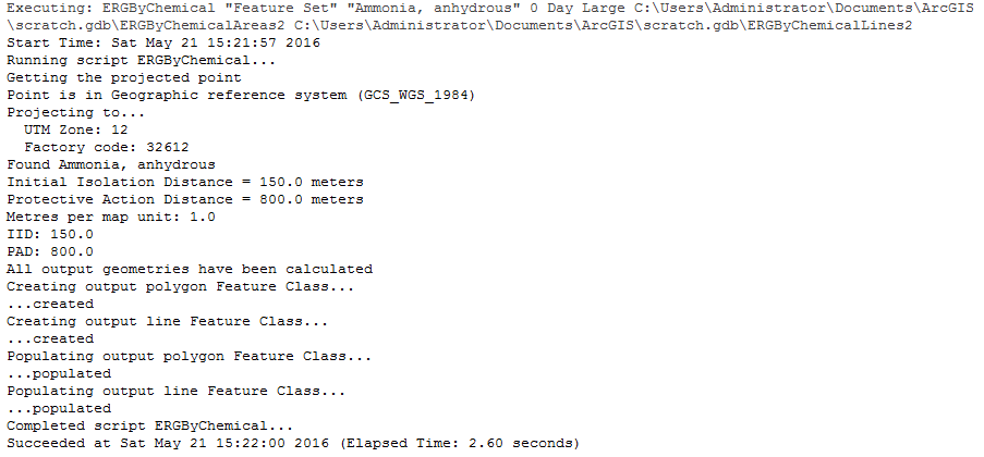

The results from the tool's execution are below:
So far, so good...

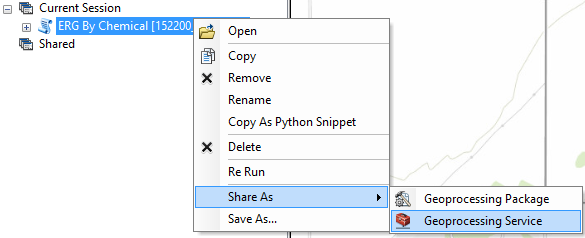

5. From the Geoprocessing Results window, I right-clicked on the successful result to create a new GP service...

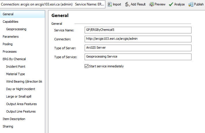

I chose to "publish a service", gave the new service a name, pointed it to the ArcGIS for Server machine...  This is the Service Editor at this point:
6. From here, I tried several options:
  • Checked and unchecked "Uploads" for the Operations Allowed option (Capabilities/Geoprocessing)
  • Switched between Synchronous and Asynchronous for Execution Mode (Parameters)
  • Checked and unchecked "View results with a map service" (Parameters)
  • Sharing: switched between nothing, My Content, my organization and a group
  • Left all other settings with their defaults
7. The Preview appeared correct, and for Analyze, no warnings appeared...
8. Clicked "Publish"...  After a minute, I get the "Successfully Published Service" message...  I was not prompted for anything during the publication...

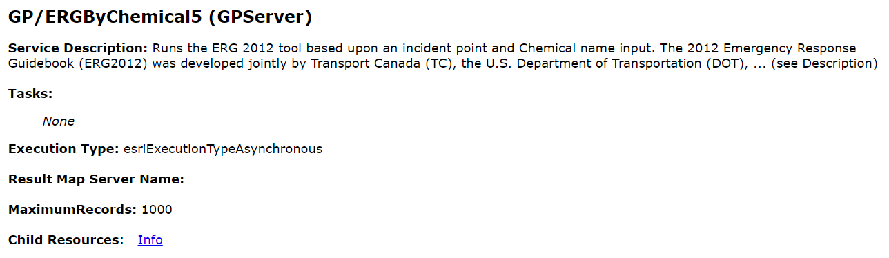

9. However, when I go to the REST URL for the new service, the service itself is created, but no tasks are published:
For all combinations of different settings as listed in #6, I get the same result...  No task...
Is there a reason why I was unable to create a GP task for this GP service?  Thinking that no input data is required beyond a user-defined point, this should theoretically be simple to publish, right?  Is there something in the Python toolbox and/or script tool that needs to be modified?  Or this there something else that I am missing?
