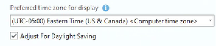

I have a script that automates generating feature services.  It all works great except I cannot figure out how to set one property.  The feature service has a setting for the preferred time zone for display
Which also shows up in the layer definition if it is set
