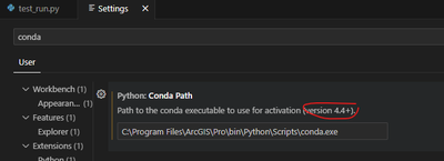

If the accepted solution didn't help, could it be the version of Conda isn't compatible with VSCode? My version of VSCode (1.78.2) seems to require Conda 4.4+. I have ArcPro 3.1 and it came with Conda 4.14, which isn't working with the accepted solution.
Brian_Wilson
Honored Contributor
I am running VSCode 1.82.0 and it says it wants conda > 4.4 too, and it works fine with 4.14 and also with the current Miniconda3 version. I am on Windows 11. What is it doing wrong for you?
Scoth
It can't seem to activate conda. It does run the script otherwise, though *shrug.Scoth_0-1694470434711.png

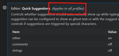

I just wanted to add my use case scenario to this useful thread which may help others? Its now 2025, I've just had a new laptop, installed ArcPro 3.5, cloned my environment to how I like it and installed VS code.
Much of my development is as embedded code in a python toolbox (atbx). When I right click on the tool and choose edit, it fires up VS Code and opens my toolbox script  as file temporary located in some sub-folder in C:\Users\hornbydd\AppData\Local\Temp.  I note that the arcpy module has that wavey yellow line under it and intellisense does now work for arcpy or networkx.
I solved my predicament firstly making sure VS Code is pointing to the right environment as discussed in the solution above. Then I went into File>Preferences>Settings. Typed into the search box quick suggestions and the text in italic after Quick Suggestions turns out to be something you can click on. I forget what the original text was but I ended up choosing Applies to all profiles. This seems to have solved the issue.
