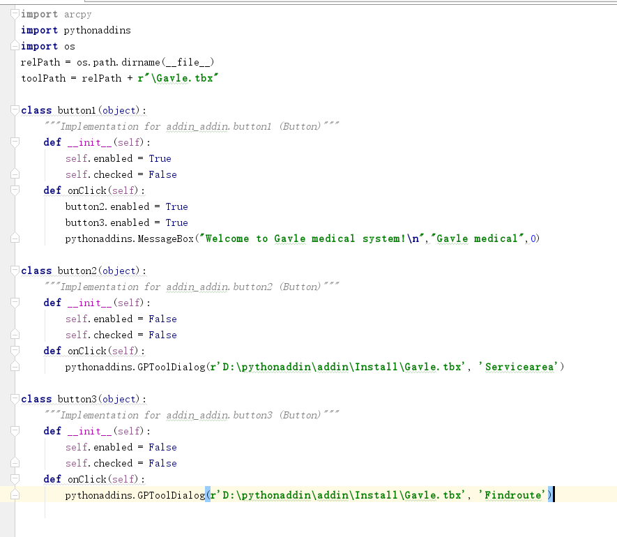

I try to click a button that I created in python add-in to execute a model (this model is made of the script tool), the button1 is ok, but when I click the button2 or button3 on the toolbar, it has an error as the title. Below are the pictures of my code and error.
Fig.1 code
Fig.2 error (look at the black part of error dialog, this error dialog repeats almost 50 times!)

I tried your post and renamed the tool, but it still has the same problem. Below are the pictures of my revised code and steps. Could you please help me to check the problem? Thank you so much.
Fig.1

A few things to try..
- try using the variable toolPath in place of the path in the GPToolDialog lines.
- try commenting out the MessageBox line.  I haven't had much luck with that. At least eliminate that as an issue.
Is the ServiceArea tool in your inbox pointing to the addin_addin.py   And is FindRoute pointing to addin_addin2.py?  And are these checked on a relative paths?  Typically my scripts in my Scripts founders are named closer to the tool the would be attached (vs a name like addin.py).  I have on .py in the scripts folder for each tool.  The actual addin.py that will be ru  to created the add will be in the install folder.  Although you may edit tweak this file, it is created when you use the wizard to initially create the addin.
As i mention on the blog, when you start editing the files direct, you will want to make sure all the variables/IDs keep in sync.
Edit:  also, make sure the tools run from the toolbox itself too, if you haven't already tested.  This should help you determine if there is an issue with finding the .py file.

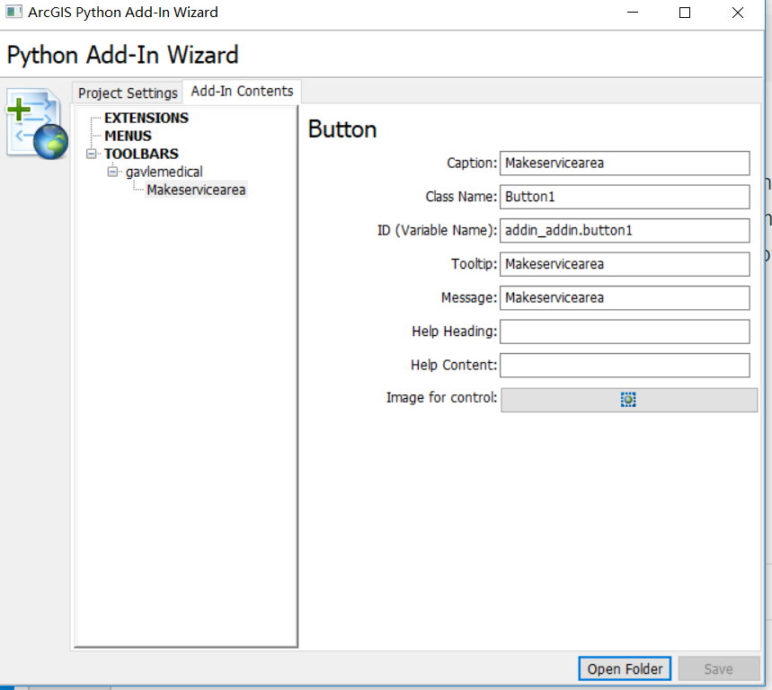

Thanks for your suggestions. I checked all the things you mentioned and revise my code and I tried so many times even create a new work, but it still not works. I feel so desperate. I am a beginner of python, so maybe I did something wrong.  If possible, could you please show me some of your folders (addin, Install and script) and python add-in wizard, because I want to compare your folder and my folder to find some differences?  The folder that I want to see as below. And I have a question. When I try to move the script addin_addin.py automatically created by wizard to the Script folder, I find the "addin_addin.py" in the Script folder is not the actual addin_addin.py, so I think maybe it is a problem but I don't know how to fix that. Do you know how to fix it? Thank you so much.

Fig.3 python add-in wizard
