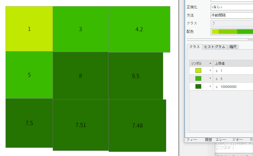

This code works as desired when you set up a layer with three or more classes.

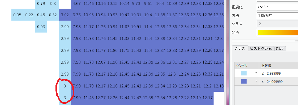

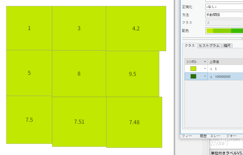

However, when the number of classes is 2, the behavior becomes strange as shown in the figure. Also, at this time, if you change "100000000" on line 29 to "1000000", it will work properly.
Why does this happen?

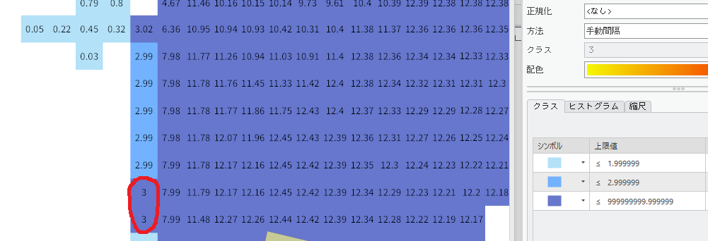

The image below shows a slightly more complex code.
The color of the "3" square has changed.
I don't know the cause of this either.
Is there any way to solve it? thank you.

The problem I'm having is that although the upper limit value is set properly as far as I can see in the class tab, the colors don't match it.
