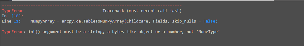

I have a script that calculates several fields in a table, then publishes that table to a sql server.
I use pandas to publish to the sql server, I create the pandas data frame using a numpy array.
I use arcpy.da.TableToNumpyArray() to create the dataframe.
Whenever line 6 is run I receive a type error int() argument must be a string, a bytes-like object or a number, not 'NoneType'.

Every other piece functions as it should with these two variable except line 6. Why
This has worked in the past, then one day it woke up and said I don't want to be friends with you any more. It is not isolated to this table, it is all tables.
I have tried to reference the table from a workspace instead of a map as well. Same error

I think Dan is right about nulls , null_value=0 replaces None values with 0. Adjust this value based on your data requirements.

is there a chance that you have nulls/missing values in your dataset (particularly in your integer fields) that need to be evaluated and replaced as per the example in the help topic?

Your solution works Tony, it would appear that two fields that were once text fields are now int fields. Which explains why it worked previously then suddenly stopped. When we recreated the tables we changed the field type of text to int.
