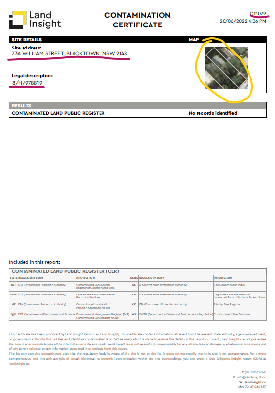

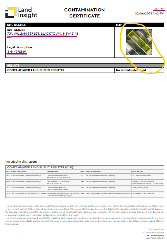

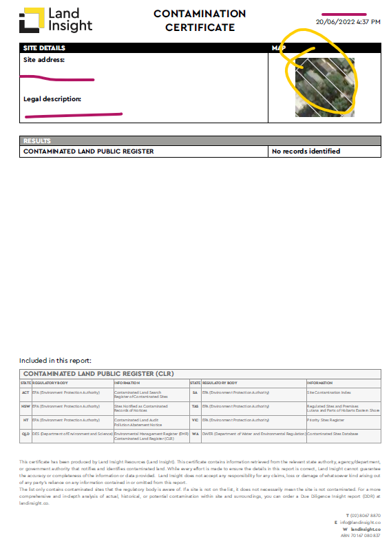

The problem arrives when I'm executing the code, the exported pdf doesn't have the symbology in the map extent (the layer displayed has only 1 polygon, the site. As this wasn't working I tried to see if it is working manually exporting the pdf, unfortunately, this time, all the dynamic values and the symbology are gone. In addition, the symbology in the map also disappears.

Here's how the export should be (notice the dynamic texts are underlined with maroon, and the site symbology with lemon yellow)
Here's how it exports with the script
Here's how it exports after running the script but this time manually
