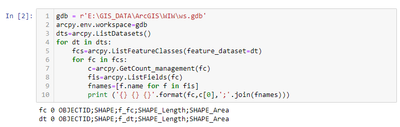

there is a dataset named "DT" in geodatabase and two featureclasses named "A" and "DT" in the dataset,  and My code is:
arcpy.env.workspace=gdb
dts=arcpy.ListDatasets()
for dt in dts:
     fcs=arcpy.ListFeatureClasses(feature_dataset=dt)
     for fc in fcs:
           c=arcpy.GetCount_management(fc)
           fis=arcpy.ListFields(fc)
           fnames=[f.name for f in fis]
          arcpy.AddMessage('{} {} {}'.format(fc,c[0],';'.join(fnames))
After run this code, it'll print the correct name and count for both featureclasses but wrong for  'DT' featureclass's fields,  as get the same as  'A' featureclass, not actually 'DT' itself's.

Back to the code - it worked well for me, but I have ArcGIS Pro, so there might be some specific bug in ArcMap. For clarity I put the code again in formatted way (please note that there is a missing parenthesis at the end of the original code by leigao):

I have add a test gdb. If both of the featureclasses in dataset all not named as the same name with dataset, it correct, but when one featureclass is named same as dataset, it will print another featureclass's fields.
SzymAdamowski
Sorry for long time in responding. I tested your  code and database in ArcGIS Pro (3.2). Works well. If it doesn't work well in ArcMap then it might be ArcMap-specific bug. Code looks OK.
