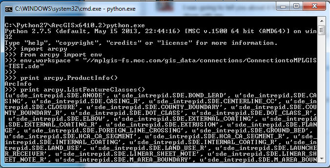

I wrote a python script that simply lists out all of the feature classes in our SDE database, which I'm running directly through the Python Shell. The script will eventually export feature classes from our SDE database to a file geodatabase via Windows Task Scheduler, but I was having trouble getting that to work, so I simplified it to do some testing. The script is below:
import arcpy
from arcpy import env
env.workspace = "//mplgis-fs.moc.com/gis_data/connections/ConnectiontoMPLGIS-TEST.sde"
print arcpy.ListFeatureClasses()
On my desktop PC (Win 7 64-bit, ArcGIS for Desktop 10.2.2), the script executes correctly and returns the list of features:

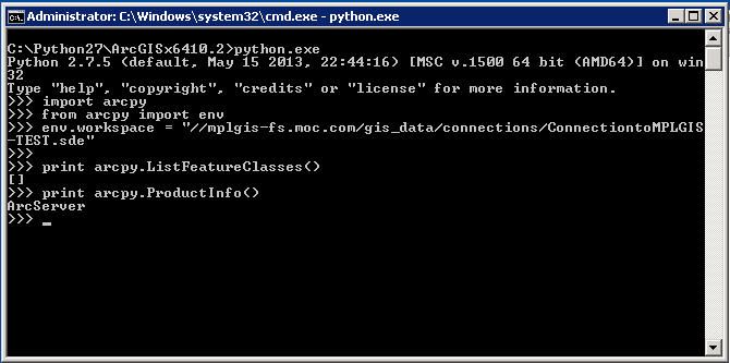

But when I run it on the server (Windows Server 2008R2, ArcGIS for Server 10.2.2), it does not return any feature classes, and I'm stumped as to why that is:
Any thoughts on what might be causing it? In the screenshots I show that the server is using the ArcServer license, while the desktop is using the ArcInfo, but I'm not sure if that should make a difference.

I finally figured out the issue (after far too long, I might add!). SQL Server Native Client was installed, but the connection file was setup using an alias to the database server, not the server name itself. The database aliases are stored in the registry on each machine and they had not been pushed to any of the new GIS servers we had provisioned. I got the registry file that I needed to create the proper entries and it works perfectly now.
