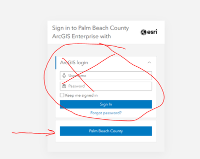

When I signin (regularly) I have to purposely click on our SSO link to sign in.  If I just use the "regular" signin portal it gives an error.  The script above takes me to the PBC SSO and logs in as evident by the "Connected to: Palm Beach County ArcGIS Enterprise" message.  The GIS object uses the token where the username and password are entered and connects correctly.  The problem is later in the script where I call the exportTOSDDraft function it "thinks" I'm not connected to portal.
