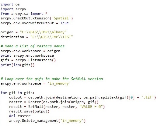

Then I checked what happened with a simple script that tries to Set Null a large number of rasters in a folder (5900) and save the result in another folder.
Now, SetNull() fails after near 1500 loops, whatever the modification I tried, and the error is saving the result (ERROR: 010240). However the same script works fine in Windows 7 and with ArcGIS 10.3.1. I think this is not an issue exclusive of SetNull(), and can occur with other functions that creates temporary data.

your in_memory workspace gets deleted in the first loop ... is that an indentation error in the code?
AlfonsoYañez_Morillo
No, it’s not. I’m trying to clean the ‘in_memory’ workspace after each loop to be sure there is no memory issues. Actually, that command is not necessary, because the temporary result from SetNull is deleted automatically after be saved.

This issue has appeared before and it has something to do with the issue of the raster saving not working as planned.  One report suggested using a physical folder location instead of in_memory... in their case, it worked.
It is worth a shot https://community.esri.com/thread/77918
That error message is typically vague, so adding print/addmessage statements would be your only option along with check using 'exists' to see if the files are actually getting deleted or just quietly failing.
In any event, the current saving location isn't working for whatever reason, so trying something new might just work

I already did what that report says, placing the workspace in an alternative physical folder and then save it in the definitive one. After that I delete the temp file. It is the same, It fails after 1000 – 1500 rounds. The weird thing is that this script works fine in ArcGIS 10.3.1 with Windows 7 and not with ArcGIS 10.5 with Windows 10.

I checked the script using .tif rasters in stead of .gif as originals and the script worked fine. I also used the gifs but CopyRaster_management in stead of SetNull and it worked too. Apparently, it is something related with the GIF format and processes that generate intermediate results. I'll sent a report to Esri.

Note - it is not good practice to set arcpy.env.workspace to in_memory.  This is because as the help warns you really don't want to fill up in_memory, which would be very easy to do if everything default is written there.
When I am doing heavy map algebra, to make temp raster handling efficient, I set the workspace and scratch to the same writable system folder -- for example:
from arcpy import env
env.workspace = env.scratchFolder
env.scratchWorkspace = env.workspace‍‍‍
If you are having issues with the map algebra and temporary rasters, you can do a direct run of raster tools (bypassing map algebra) like this. If you are running through 5000 rasters this may be more efficient, bypassing saving a temp raster in .tif format:
for gif in gifs:
  arcpy.gp.SetNull_sa(gif, gif, os.path.join(destination, gif), "VALUE = 0")‍‍‍‍‍‍
