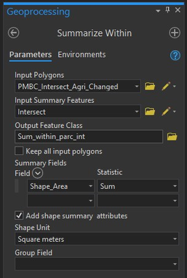

Next, set the Summarize Within tool to summarize the Shape_Area field of the output of the Intersect using the parameters in the image below:

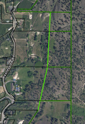

Parcels are black, and zoning is green in this example, where the parcels that are most appropriate to be selected don't have their centre in the zoning:
If I just use "Intersect", parcels intersecting the borders of the zoning polygon get chosen in addition as the appropriate parcels, which are not relevant at all and are unwanted.
Trying to remove the unwanted polygons from the selection one by one is very time-consuming, imperfect, and inefficient.  I would love to know if there's a process to just get the parcels that are affected by the zoning polygons, no less, and no more, using geoprocessing.

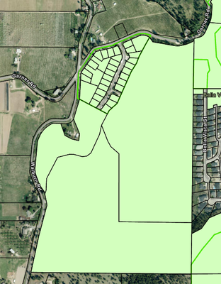

Selected parcels are in the pale green.
What do I do from here to eliminate them?  It still goes back to the original problem: I only wanted parcels who share the largest overlap with the zoning.
