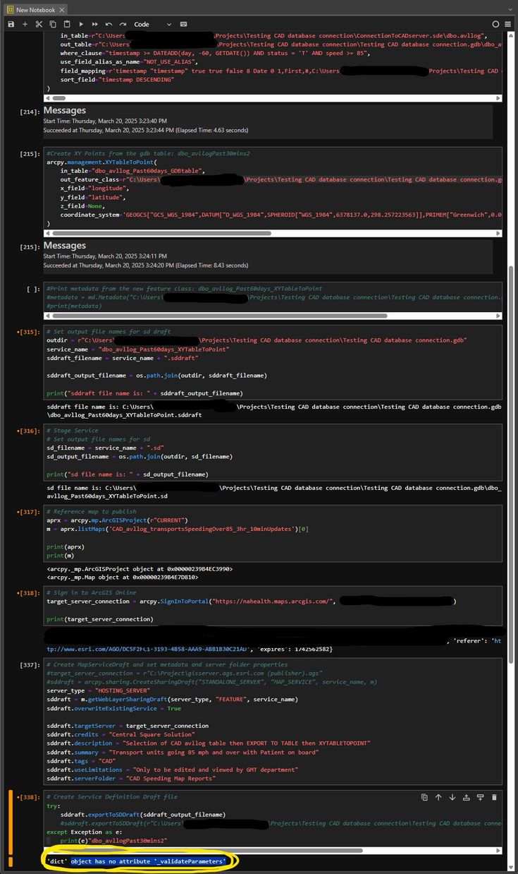

My script will complete steps 1-3, but at step 4 I am getting this error:
'dict' object has no attribute '_validateParameters'

Error can also be seen at the bottom of this screenshot (screenshot is also attached, incase this one is showing up too blurry) of my Notebook:

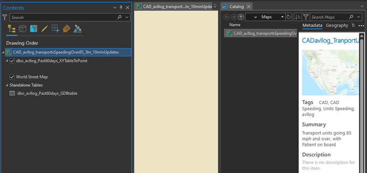

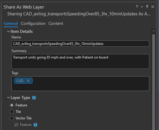

I have filled in the Name, Summary, and Tags (required items in order to publish or overwrite a web layer) for my map:
When I complete steps 1-3 above in my Notebook, those required items stay in place for the Map:
However, when I complete steps 1-3, the required items in the Feature Class will disappear, not sure if I need those required items in the Feature Class when I do a Share > Publish Web Layer / Overwrite Web Layer:

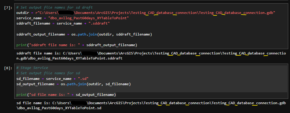

It looks like you are placing the sddraft_output_filename and your sd_output_filename in your file geodatabase. It more than likely doesn't like the '.' (dot)
Set these to another folder that is not a .gdb
After that, if not working, test commenting out sddraft.serverFolder (or replace for sddraft.portalFolder)

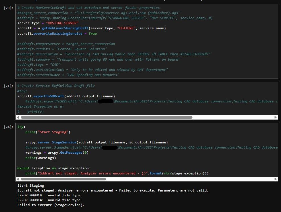

I commented out all the credits, description, summary, tags, use limitations, and server folder. I was able to get that cell to complete, which was the one originally giving me the error:
But then the next cell is still giving me this error now:
Start Staging
Sddraft not staged. Analyzer errors encountered - Failed to execute. Parameters are not valid.
ERROR 000814: Invalid file type
Failed to execute (StageService).
This is what it looks like on my notebook for the commenting out of the parameters and the new error code I am getting:
Going to also see if creating a new project with no spaces in the title and no spaces in the .gdb title might fix it. I did the suggestion Clubdebambos said of just removing sddraft.targetServer and I left everything else the same in the script (like in my original post) and I got this error (I also shared it in my reply to his response):
ValueError: Service and/or folder name contains unsupported characters: ' '

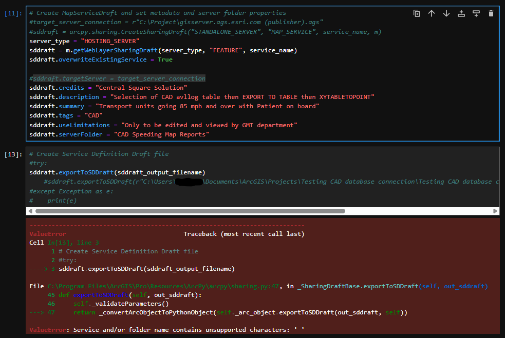

I commented out the sddraft.targetServer = target_server_connection :
And now I'm getting this new error:
I'm thinking it's because of the spaces in my project title and gdb title?:
~ learn.finaldraftmapping.com
eallan
That was the fix @Clubdebambos ! Thank you so much for helping me find the issue and correction for it. I ended up figuring this out yesterday after I spent a couple hours going through my code (ahhhh!) when I should of just checked back here and looked at your response ha.
