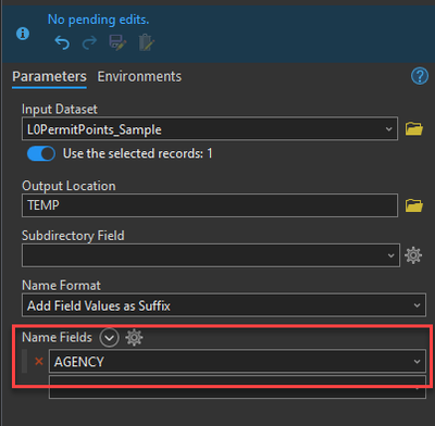

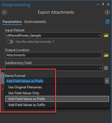

Hi @SamBelisleLID1990, take a look at the Export Attachments tool, which is new at ArcGIS Pro version 3.3.  This tool provides options on how to handle the name format of the exported attachments:
SamBelisleLID1990
Thank you @JakeSkinner, I am able to name the files according to the field values. The problem is that I can't get it to recognize the duplicates. The first attachment will download with the correct file name, then the second attachment will overwrite the first attachment with the same file name, meaning the data is not captured instead of saving as a new file.
JakeSkinner
Esri Esteemed Contributor
If you specify Add Field Values as Suffix it will handle duplicates by adding an _1, _2, etc.
