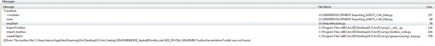

I have a py script that calls a function from another py script, and I am getting the below error:
IOError: The toolbox file C:\Users\benva\AppData\Roaming\Esri\Desktop10.3\ArcCatalog\GISADMIN@[email protected]\SDE_SPATIAL.GISADMIN.ToolboxServerAdminToolkit was not found.
I am unsure why the below sequence is occurring, I am completely stuck and unsure how to resolve.
2015-03-06_08-48-05_2015-03-06_08-33-55_Inbox - Microsoft Outlook.jpg - IrfanView (Zoom 1900 x 960).jpg

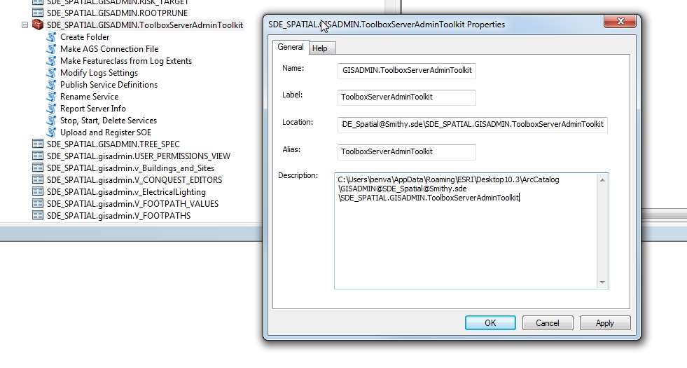

I have double and even triple checked this directory, and the toolkit most definitely resides in this location, please see evidence of this in the below screen grab:
2015-03-06_08-38-08_ArcCatalog - CUsersbenvaAppDataRoamingESRIDesktop10.3ArcCatalogGISADMIN.jpg

A solution has been found, we had to set the workspace in both the original script and the second script to be identical, now it seems to work fine.
Cheers
