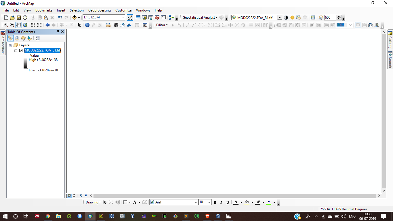

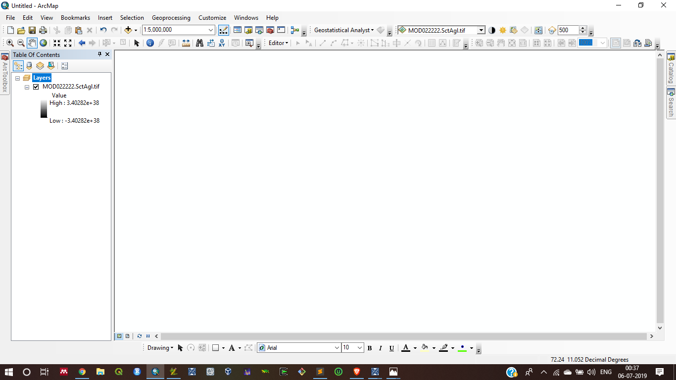

BIJOYGAYEN
Hello Xander Bakker‌ sir,
I rechecked my code as per your suggestion, But when I try to save the output SctAgl  and toa_b1 after some processes this code gave me some error in output (the output gave me blank result with unwanted value range in two images)
SctAgl:
Toa_B1:
Second, when I run this code it shows some unwanted messages, I cannot understand why these messages occur

  sinSenZ = np.sin(sinSenZ_na * np.pi / 180)
F:\DB_test_data\python_script\FINAL_DB.py:304: RuntimeWarning: overflow encountered in multiply
  sinSolZ = np.sin(sinSolZ_na * np.pi / 180)
F:\DB_test_data\python_script\FINAL_DB.py:304: RuntimeWarning: invalid value encountered in sin
  sinSolZ = np.sin(sinSolZ_na * np.pi / 180)‍‍‍‍‍‍‍‍‍‍‍‍‍‍‍‍‍‍
Third things, when I try to run this code with row data (whole India) after some processing it shows memory issue
    sinSenZ_na = arcpy.RasterToNumPyArray(senzen)
  File "C:\Program Files (x86)\ArcGIS\Desktop10.6\ArcPy\arcpy\__init__.py", line 2275, in RasterToNumPyArray
    return _RasterToNumPyArray(*args, **kwargs)
MemoryError
There is no option, without conversion (Raster To Numpy and then Numpy To Raster) to write the code for raster data analysis directly use cos, sin, subtract, plus, minus, division function, etc. I am totally confused to write this code. Give any solution regarding this issue.

XanderBakker
Esri Esteemed Contributor
Hi BIJOY GAYEN ,
Have a look at these functions that are available in Spatial Analyst:
