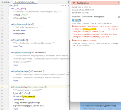

I am developing .pyt Python Tools with pre-existing code that I am porting into the .pyt format.

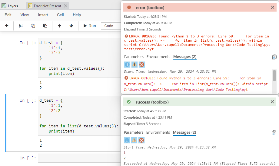

The Python code works when scripts are executed within Custom Toolboxes (.atbx), and as standalone python scripts from command prompt or my IDE (PyCharm). When I include some custom classes and functions in the .pyt from the scripts and run I get this error: ERROR 001683: Found Python 2 to 3 errors. Below is the error message and concise reproducible .pyt examples of the type of issue demonstrating error and success (following recommended edit).
I also tested the relevant error and success snippets in an .ipynb where both return the same output. Why does the .pyt error out from this code difference when the .ipynb and other Python environments do not?

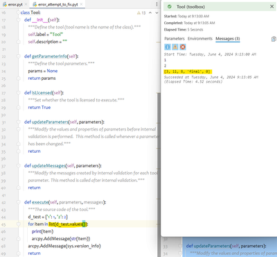

success .pyt:
# -*- coding: utf-8 -*-
import arcpy
class Toolbox:
def __init__(self):
"""Define the toolbox (the name of the toolbox is the name of the
.pyt file)."""
self.label = "Toolbox"
self.alias = "toolbox"
# List of tool classes associated with this toolbox
self.tools = [Tool]
class Tool:
def __init__(self):
"""Define the tool (tool name is the name of the class)."""
self.label = "success"
self.description = ""
def getParameterInfo(self):
"""Define the tool parameters."""
params = []
return params
def isLicensed(self):
"""Set whether the tool is licensed to execute."""
return True
def updateParameters(self, parameters):
"""Modify the values and properties of parameters before internal
validation is performed. This method is called whenever a parameter
has been changed."""
return
def updateMessages(self, parameters):
"""Modify the messages created by internal validation for each tool
parameter. This method is called after internal validation."""
return
def execute(self, parameters, messages):
"""The source code of the tool."""
main()
return
def postExecute(self, parameters):
"""This method takes place after outputs are processed and
added to the display."""
return
d_test = {
'1':1,
'2':2
def main():
for item in list(d_test.values()): #line not causing error
print(item)
arcpy.AddMessage(str(item))
error .pyt:
import arcpy
class Toolbox:
def __init__(self):
.pyt file)."""
self.tools = [Tool]
class Tool:
def __init__(self):
self.label = "error"
params = []
return params
return True
return
return
main()
return
return
d_test = {
'1':1,
'2':2
def main():
for item in d_test.values(): #line causing error
print(item)

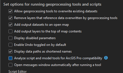

HaydenWelch
MVP Regular Contributor
It's this setting, I don't have the issue because it was disabled by default in my previous User config which was ported to 3.3, but they must be enabling it by default now and that's insane... (Under Geoprocessing BTW)
Also please mark this reply as the solution. If this is a new thing they're doing the 3.3, then this issue is gonna start appearing more and I want people to be able to find the solution without reading through this whole thread lol

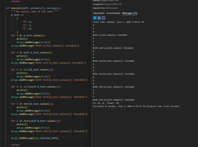

I definitely jumped the gun on my solution, it seems that your error is coming from your Python syntax being Python 3 while the environment for your toolbox is Python 2. ArcGIS Desktop, ArcGIS Server, and ArcGIS Engine all still use Python 2 so if you're using one of those you'll need to refactor to use Python 2.
I test the toolbox code in ArcPro 3.3 and it runs fine:
import arcpy
class Toolbox:
    def __init__(self):
        .pyt file)."""
        self.tools = [Tool]
class Tool:
    def __init__(self):
        self.label = "Tool"
        self.d_test =\
                "a": 1,
                "b": 2,
                "c": 3,
        params = None
        return params
        return True
        return
        return
        d_test =\
                "d": 4,
                "e": 5,
                "f": 6,
        for i in list(d_test.values()):
            print(i)
            arcpy.AddMessage(str(i))
        for i in list(self.d_test.values()):
            print(i)
        return
        return
So you just need to make sure that your arcpy environment is using Python 3

Hi @HaydenWelch ,
I see your successful run includes:
 to loop through the dictionary values. That is why your code doesn't throw an error on tool execution. If you change it to:

To further clarify the full issue scope. I have this issue I presented with a Python 2 to 3 error caused by not passing the dictionary.values() iterator to list() so it becomes an iterable. I also have the Python 2 to 3 error in other cases while I am porting some legacy code (classes and functions) into a .pyt so it is more user friendly. Can you shed any light on the question of why the code will execute without issue in .ipynb and IDE's setup to use the default ArcGIS Pro 3.3 environment, but cause the Python 2 to 3 error when ran in .pyt?
I really appreciate you engaging me on this issue!

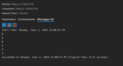

I tried the test again with a raw .values(), a list cast and an iter cast and all returned the same results.
Have you tried outputting sys.version_info? Just import the sys module and add that last line to your code and see what's going on.
BenCapell_NWTF10
As an initial note I'll add that from my web searching there is a technical difference between list() and dict.values(): list() creates an iterable, while dict.values() returns an iterator. So that's a slight difference from your note "There shouldn't be any difference between list(dict.values()) and dict.values() as both return an iterable object."
  • I am not able to successfully run your first for loop above "with d_test.values() iterable".
  • When I wrap d_test .values() with list() it works and prints my python environment info which matches yours. So now I need to figure out what is going on with my setup that is different from yours.
