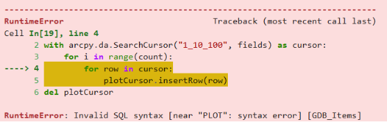

When I run this, I get this error:
Thanks!

You’re very close, but the cursors are flipped and you’re passing the tuple list as “fields” (that’s why it blows up).
SearchCursor should read from Forest_Surface_Fuels (source)
InsertCursor should write to 1_10_100 (target)
InsertCursor("Forest_Surface_Fuels", fuelsTuple) is wrong because the 2nd argument must be a list of field names, not row data.
If your goal is: for each input feature, create 4 rows (Macroplot Pre/Post x Transect 1/2) and pull values from those named fields, do this pattern:
out_fields = ['Plot_', 'SurveyType', 'Transect', 'OneHour', 'TenHr', 'HunHr']

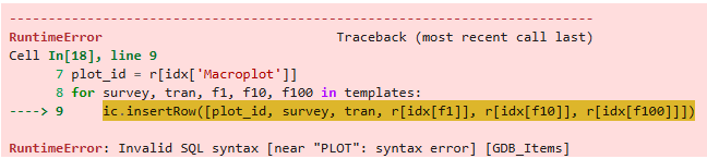

I keep getting an error, but want to confirm something first, when you define src_fields, where you have 'Plot_' that should be the corresponding field in "Forest_Surface_Fuels" to 'Plot_' in the out_fields, correct? I replaced 'Plot_' in those instances with 'Macroplot' and still get this error:
Yes — src_fields must be the field names in Forest_Surface_Fuels, not a value like "Macroplot". So don’t replace Plot_ with "Macroplot" in src_fields. "Macroplot" should be the value you insert, not a column name.
About the error you’re seeing:
RuntimeError: Invalid SQL syntax [near "PLOT": syntax error]
That usually happens when the target table has a field name that the underlying database treats as problematic (often a reserved word like PLOT, or a name that needs quoting). arcpy.da.InsertCursor builds an INSERT statement under the hood and can choke on that.
What to do:
Confirm the exact field name in the output table (not the alias). If it’s PLOT / Plot / Plot_, verify spelling/case.
Rename the output field to something safe like PlotID (best fix).
Re-run the cursor after renaming.
So: keep src_fields as real source column names, and fix the output field name that’s triggering SQL near PLOT.
