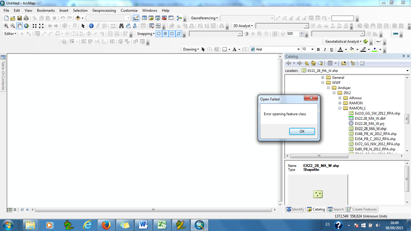

I have a list of SHP files that I want to rename. First, I want to replace the "." from the shp to "_", and then rename the file. As you can see in the image below:

The problem is that when I am trying to open the SHP file it does not work. I am getting the following error message:
Does anyone knows how to fix the problem...

The code seems to work... it does not give any error message in PyScripter...But when I am trying to add the shp to ArcMAP it gives the following error:
