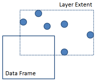

DarrenWiens2
MVP Alum
I suppose you know that even though no features overlap the data frame, the extent may overlap:
Yaron_YosefCohen
Darren you understand me exactly. How can i solve this issue?

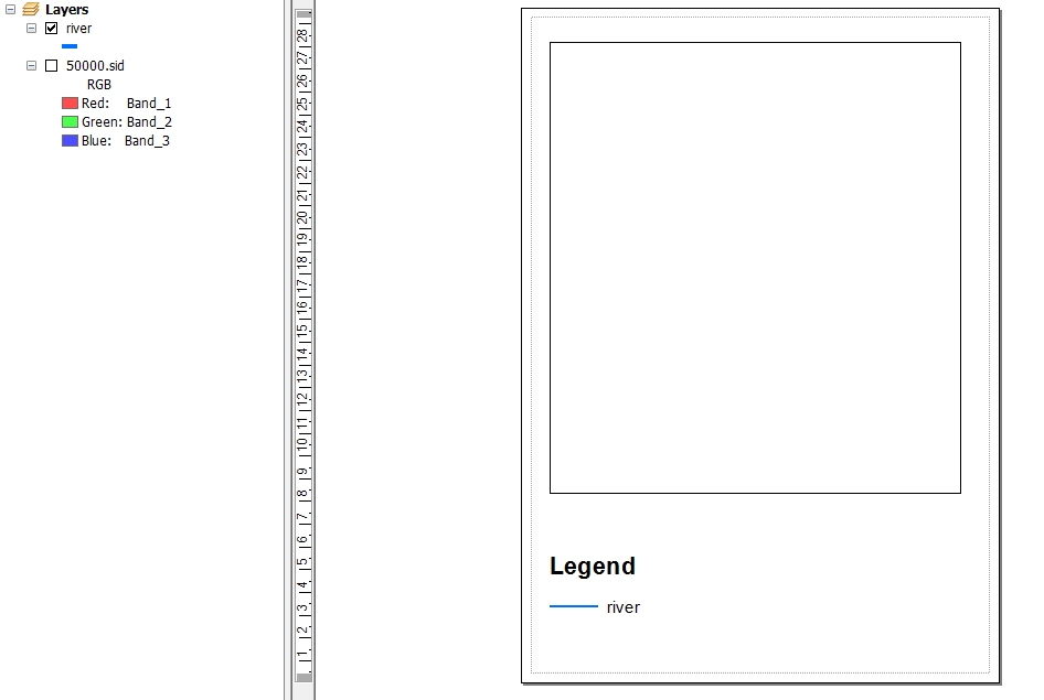

Yaron_YosefCohen
When i use  extent.overlaps it remove land use layer- that ,in fact do exist in the layout, and finally i remain with river layer that don't exist in layout -but it extent coordination do cover the layout view:
DanPatterson_Retired
MVP Emeritus
You now have a disconnect between your dataframe and its layout view, go back and zoom to the extent of the data (one of the layers) or to the full extent.  Does your image now appear back on the layout view?  If not, then you have your layout fixed and it doesn't change asyour data frame changes
