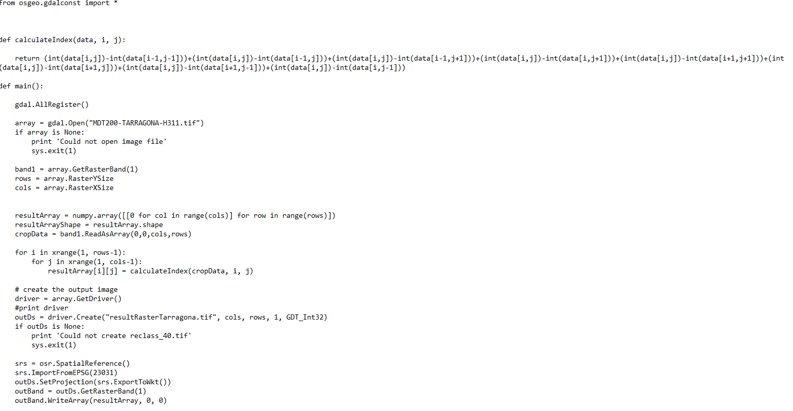

that is the code comented yesterday. Any help!?

It would be more helpful if you would follow the suggestion by Chris Donohue on Posting Code blocks in the new GeoNet .
You don't seem to use any ArcGIS (arcpy) components. Is there any particular reason why you post your questions at GeoNet?

I don't use ARCGIS components because I don't know them, I am starting with python. I use python to get a raster to work in arcgis. For this Iam writting here.
