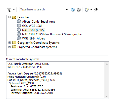

I have been trying to run both the Line Density and Euclidean Distance processes within a script and am being given the same error in both cases. Both processes will use the same layer as input. The coordinate system for the input appears to be fine. Any thoughts?
****EDIT****
I have included the coordinate system info. below.

those are geographic coordinates... project your data before you do any planar calculations (ie Euclidean).  if you are in NB, project it to one of NB's provincial scale coordinate systems, and/or an appropriate UTM zone for your area...

Yikes, suppose sometimes you just need another set of eyes and another perspective. Thanks Dan Patterson
