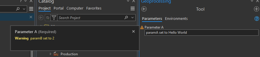

Will show up in ArcPro when opened like this:

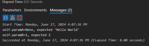

Showing that those assignments did in fact get run, but when you run the tool:
The instance attributes were never updated.

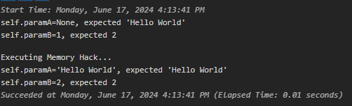

Will return:
I guess this means that the tool object is being constantly rebuilt by the interpreter. Is there a good internal reason for this? There are valid reasons for someone to want to store data in an instance attribute (e.g. an expensive data check or calculation that has to be done during the validation loop, but can pass those validated values on the the execute loop), so why is the Tool object being re-initialized over and over instead of either mutated or re-initialized as a carbon copy of the original object and its __dict__?
