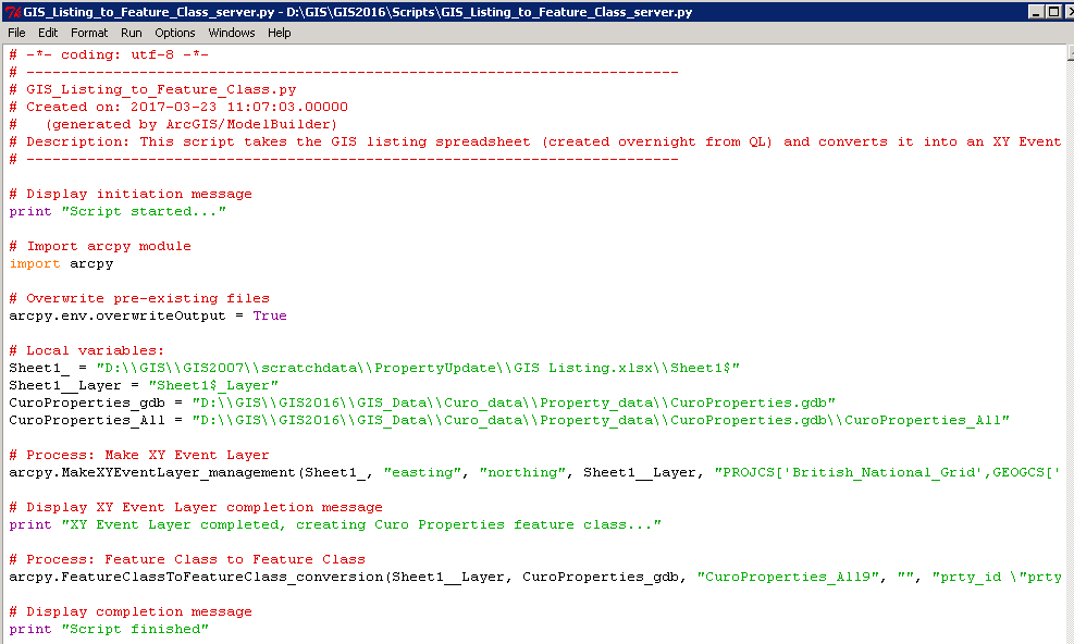

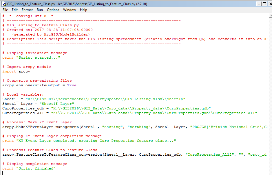

Hi. I have a script created in Python 2.7.10. It runs without issue on a machine with 2.7.10 installed:
(spreadsheet>>>XY Event Layer>>>Feature Class)

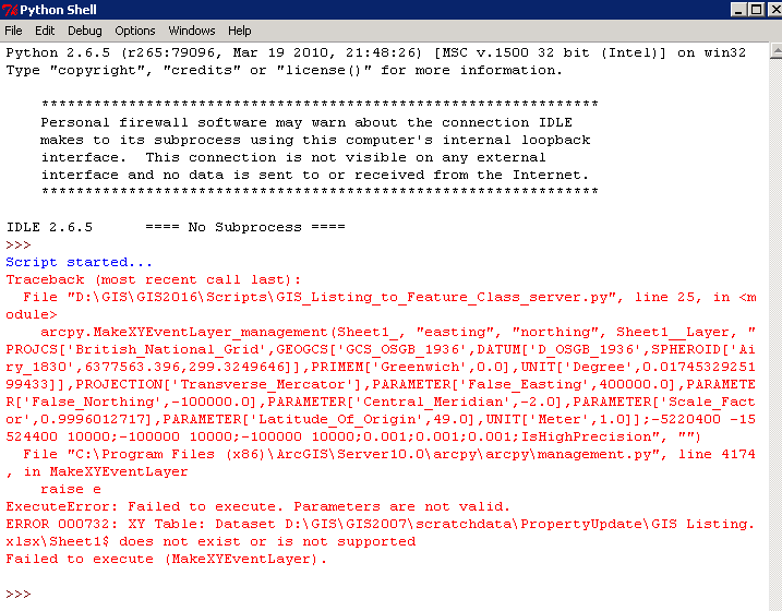

But on a machine with 2.6.5 installed, it errors. Why is this?:
Is it because I'm trying to make an XY event layer from a sheet within an Excel spreadsheet, and I don't have Microsoft Office installed on this second machine (no licence)? Screenshot below shows the spreadsheet needed for the XY event layer, and it's showing up as an unassociated file type (no program found to open it).
I didn't think Microsoft Office would be needed for Python to be able to extract a sheet. I've also experimented with making a CSV version of the file and pointing the script to use that, but the same error appears.
Any thoughts most welcome!!!

Well, it could be the simple reason that python 2.7.* is required for ArcMap related scripts.  Otherwise you would have to dig in the changelog between python 2.6 and 2.7 to see what changed there.  There is no reason for 2.6 to be installed and/or used on a machine with ArcMap.  Uninstall it and use 2.7.  And .xlsx files aren't support in those lower versions anyway, when you get it resolved use .xls files

ArcGIS 10.0 has been Retired for nearly 15 months. I'd be afraid to use the ancient Python that shipped with 10.0 for even non-ArcPy use.  Attempting to use a modern ArcPy script with an ancient ArcGIS build isn't likely to be successful.
