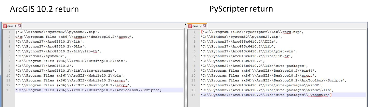

The script seems to be okay in ArcMap.  The code also runs okay in Py.Win.  I ran sys.path in both ArcMap and PyScripter.  The returns were pointing to different folders in Python27.  I think this maybe the problem but not sure, and if it is, I am not sure how to remedy the problem.  I'll attach a screenshot.  Any suggestions???Sys Path compare.png

Did you install the 32-bit or 64-bit version of PyScripter?  From your screenshot it looks like the 64-bit version.  ArcMap is using the 32-bit version of its python install (C:\Python27\ArcGIS10.2) when background geoprocessing is turned off.

I do have the 64 bit pyscripter installed and am running the 64bit machine.  I believe that i have installed background geoprocessing in ArcMap.  Do i need to call background geoprocessing out in python?  Not really sure what my next steps should be...

  • "C:\Python27\ArcGISx6410.2\Lib\idlelib\idle.bat"
Does this complete successfully?  Do you get the 999999 Error when using PyScripter or another method to run your standalone scripts? Try using the 32-bit version of PyScripter.
HeathAnderson
I ended up installing PyScripter for 32-bit.
