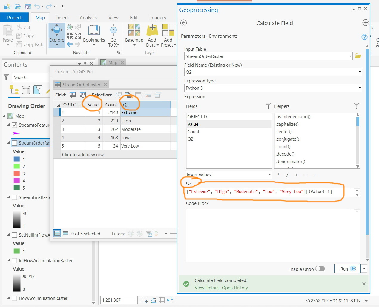

JamalNUMAN
Legendary Contributor
Great. It works for me. Very much appreciated
["Extreme", "High", "Moderate", "Low", "Very Low"][!Value!-1]
