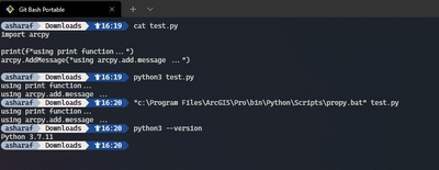

Have you used print or addmessage for the status report?  I can run the a simple script (see below) in Git Bash and it works fine.
I tried it with the both methods: 1) the one i always use (python3 alias) and 2) the one that Josh suggested. (using propy.bat file) and both works as expected.
GaryB
What if you sleep for a few seconds after your two statements that ouput text, do you see the messages before the sleep or after?
AzinSharaf
yes it pauses after two print statements and then script ends.
