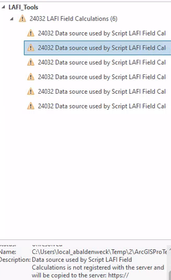

I tried adding these paths as parameters and was informed that they would be copied to the server because they're not already registered with it.
I'm having a hard time expressing how utterly takenaback by this behaviour I am. There's no reason for it to try to copy services. That's the whole point of pointing to a URL.
How can I get this to just publish? I don't even know why it's trying to make a map service.
