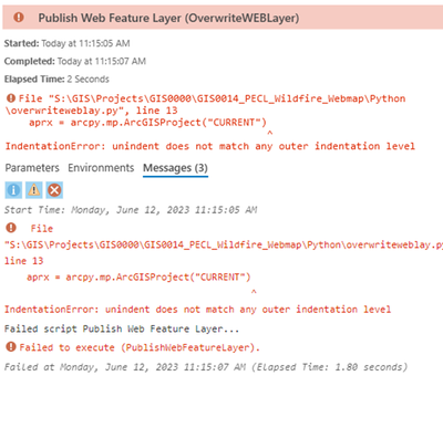

This is the code I’m using:

and this is the error:
AlfredBaldenweck
MVP Frequent Contributor
That's an easy fix so far.
Basically that line (#13) is out of line with what's around it. Make it line up with lines 12 and 14 and that particular error will go away.
Python recognizes things like loops or parts of functions by the indentation.
