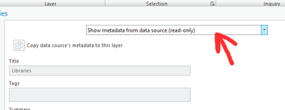

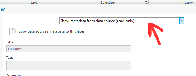

I have a simple question - I'd like to change the value of this dropdown box programmatically (in Python) for a large number of layers in a large number of layer files.
The default setting for loading .lyr files into pro sets this to 'Layer has its own metadata'. This is also the case when loading programmatically via LayerFile("uri-to-layer.lyr") I want to run a Python script to reset this to 'Show metadata from data source (read-only)', as is possible in the Pro UI.
