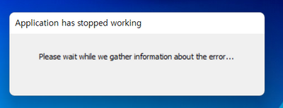

I try to monitor the folder using the Watch Dog library, if the images are downloaded the code applies three processes:
1- Move images to the destination folder
1- extract compressed images
2-add raster to mosaic data set
  • but when calling the function using arc py to add raster to the mosaic dataset in the function watch folder it stops without describing the error and gets the message window "application has stopped working"
  • when calling the function to add a raster to the mosaic dataset alone with the same parameter run success
