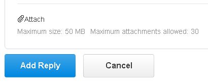

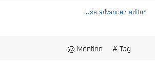

You should open the thread: Path Distance erratic and crashes in a loop  and when you create a comment you will see in the upper right corner the link "use advanced editor":
In the advanced editor in the lower left corner you will find a link to attach data to the thread:

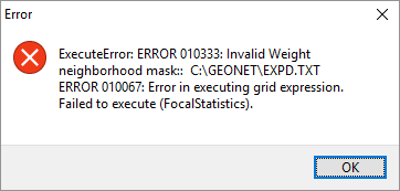

So I tried to run the code and a number of errors occurred. The first one was with the Focal Statistics using the weight kernel from the file EXPD.TXT. Although it seems perfectly OK, it throws an error:
To be sure it wasn't any problem with the path I changed the location of the file, but with no luck:

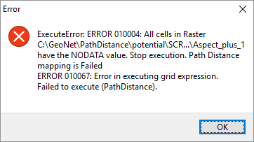

I switch off that part in case the rPthPot.maximum is None and let the code run again and this time it finished the first iteration but came up with this error:
The raster contains all NoData cells and can't be used for the Path Distance. So maybe you can functionally describe what you are trying to do, since there are a number of things in the code that don't make sense to me.
