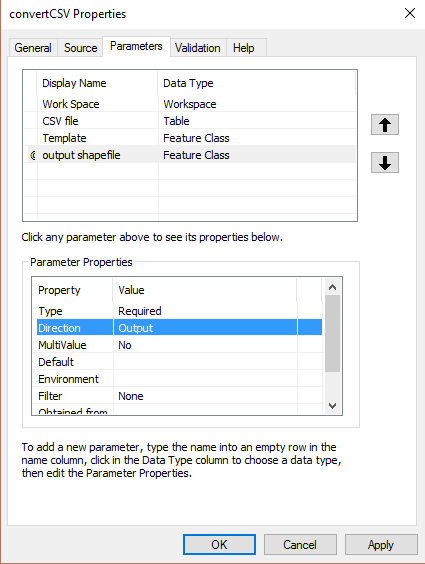

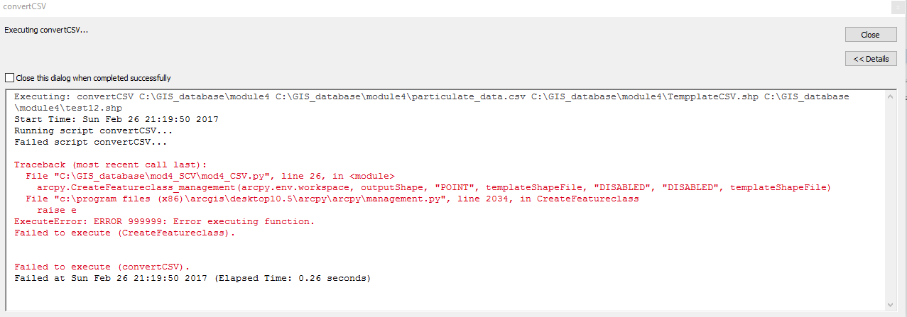

I try to specify an argument for output shape file to create it (outputShape = sys.argv[4])
and to get the shape file name from parameters. Then I set the output file parameter as a feature class and output. But my output parameter doesn't work. the script is as follows.
Why Cannot I get the output name from parameters?

The second parameter of the arcpy.CreateFeatureclass_management function should be a string and not a Feature Class

babakkasraei
Great help, Thank you
I changed the parameter value to string and it worked.
