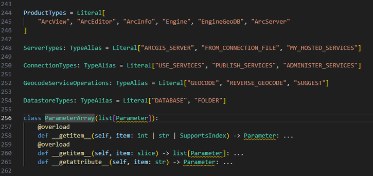

Hmmm, that's odd (I'm also using the Basic, tho I never got the MVP license and had to pay for a personal one). I only just now noticed it when my language server suggested it while importing Parameter:
I also get an import error when I actually import it, but the name exists in the __init__.py*i* file meaning that it's an interface for something in the C code. Possibly just accidentally published to the public API before it was implemented?

That makes more sense, they must have just added that to the root typestub recently, as I've never seen it before.
Was kinda hoping that they had an official api for named parameter access that could be used in Python tools lol.
