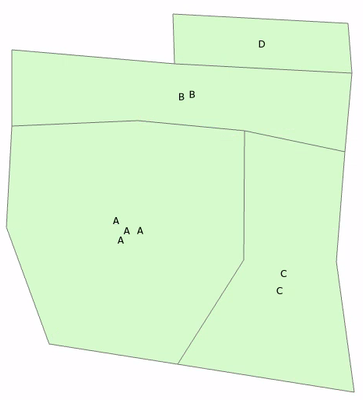

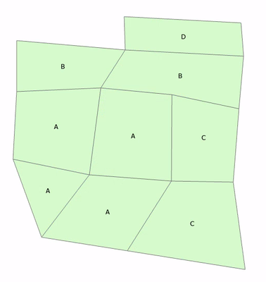

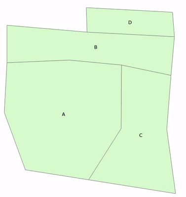

Before:
With only_keep_first == True:
With only_keep_first == False:

Before:
