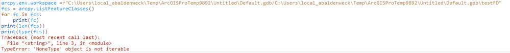

It appears that one of your iterables in thisFD are None, so we would have to get around that, optimally reporting the error as well, here is something to try:
if thisFD = None:
     print('thisFD is None, skipping')
else:
     for FCs in thisFD:
          {rest of your code}
 I can't really tell where your indentation should start and end, the formatting seems to have not came through, so everything that should be within for FCs in thisFD should be contained in {rest of your code}.

It would help to see your code in the code-style font/format.  You can do that by clicking the button to expand the toolbar (when you are writing a reply here), then click the </> icon to insert code.
I see that you are using the variable "thisFD" for arcpy.ListFeatureClasses().  For me, this variable name could cause a little confusion and obscure a possible reason for your error.  I would expect "thisFD" to represent the feature dataset name or object, so I would not expect it to end up as None, because how would you have a feature dataset name for a nonexistent feature dataset?  But since the variable is representing the list of feature classes within the dataset, you could have a feature dataset with nothing in it.  So the variable could represent None (no feature classes).  That's where I find it could cause confusion.  Personally, I find it helpful to use variable names that very literally indicate what they represent.  I think if the variable name was something like "fc_list", it would very clearly indicate what it represents, and it would indicate that it could be empty/None, because a list can be empty.  I agree with what the previous person said, to add handling to deal with an empty list.

In this, I've added a few print statements to record the current FDs and thisFD values, this should clear up when the program is causing the error, such as the supporting error message, but that will now be avoided.

Hey @CodyPatterson thanks for the reply! When I run it with your changes I get this error "Traceback (most recent call last): File "D:\Users\dmckay\Documents\FeatureCountAutomation_OG_Test\CODE\FeatureCount9UtilFDs_R1.py", line 28, in <module>
arcpy.AddMessage("Current FDs value: {}").format(FDs)
AttributeError: 'NoneType' object has no attribute 'format'"
This NoneType error is confusing me because I know there is data inside the datasets that I am choosing but my code must be wrong somewhere.

I'm confused as to why it would be returning a None at all? It should be returning an empty list.
See: I test on an empty feature dataset.
Actually.
The reason you're having a problem is this:
gdbpath + "/" + FDs
It's not joining the GDB path and the feature dataset name, it's joining the gdb path and feature dataset path.
C:\Users\local_abaldenweck\Temp\ArcGISProTemp9892\Untitled\Default.gdb/C:\Users\local_abaldenweck\Temp\ArcGISProTemp9892\Untitled\Default.gdb\testFD
Your UtilsClass is returning the full path of the Dataset. I'm not 100% sure what you're doing here, but you need to either use the FDs variable as the workspace environment. (Or maybe replace part of the path with the working gdb in the first parameter? idk)
Also, it will be less headache for you to use the os module for path manipulations in the future.
fdPath = os.path.join(gdb, fdname)
is cleaner than
fdPath = gdb + "\\" + fdname
