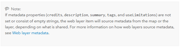

The documentation states:

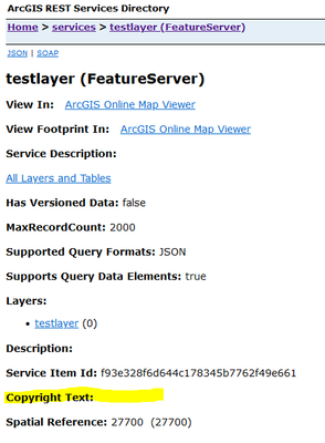

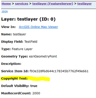

However, when we publish layers using arcpy, the credits/copyright is not populated on the resulting feature service or feature layer (within the service):
If we override the credits after generating the sddraft (using sddraft.credits = "Some text"), the copyright is populated at the feature service level, but not at the feature layer level.
For the credits to appear correctly in map viewer and apps, they need to be populated at the feature layer level.
