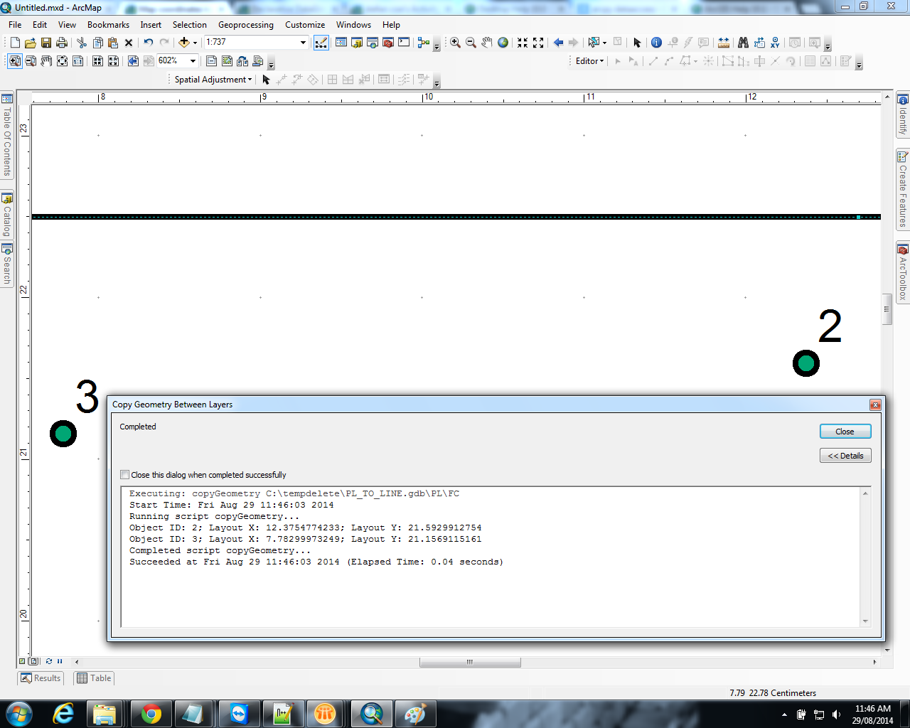

Is there an arcpy function that reports page coordinates (on the layout) for map features (in a dataframe)? (Not looking for the way to derive this manually)
RiyasDeen
Hi Darren,
I doubt there is a function available readily.
Attached script gives below output. If this is what you wanted.
RiyasDeen
Hi Darren,
DarrenWiens2
MVP Alum
Thanks, Riyas. That is approximately what I came up with, although your code did spur some new refinements. I was hoping to find a secret corner of arcpy that I'd been missing (with functions I've been without), but it sounds like it may not exist. Thanks again.
