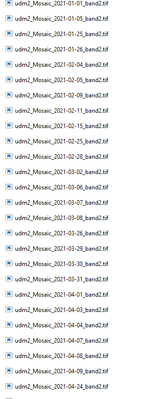

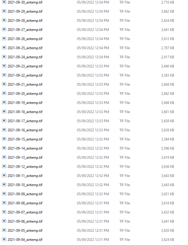

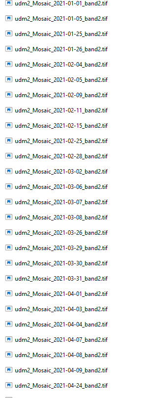

All it is showing the else statement even though the dates match.The placement of the dates vary but the format of dates are similar.These are the images in location_b
These are the images in location_a

  • You have location_a and location_b the wrong way around (or you mislabeled your screenshots).

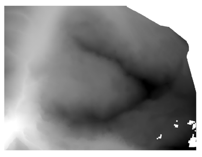

Thanks @JohannesLindner for your suggestion. I updated the code as per your suggestion, the images whose dates match are being stored but somehow all the images have the same pixel value of 1 replaced by 0 which is incorrect.
For example this is one of the output stored where the pixel value of 1 is replaced with pixel value 0, and pixel value of 0 is replaced with the pixel value of another raster.

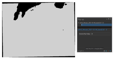

But the binary image with 1(grey color) and 0 (black color) pixel values looks like this:

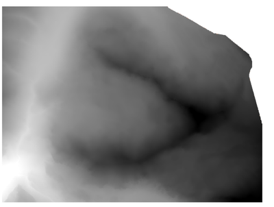

And the image with which the pixel values of 0 in binary image will be replaced is:
