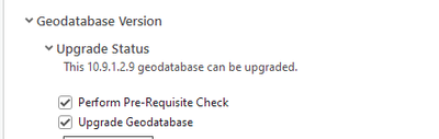

Your script is working as expected for me.
I tested on machine with Pro 3.2.1 and one with Pro 3.1.3, both connecting to SQL server sde 10.9.1.2.9 database.
Not all the featureclasses in my feature dataset have relationship classes, but many do and they get reported just the same.
