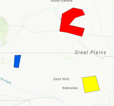

My test data is three distinct shapefiles in three folders:
  • Downloads\testFR.shp
  • Downloads\test\testFR.shp
  • Downloads\testmdb\testFR.shp
They are named the same for this particular workflow, but they have different records.
The code checks a dictionary of folders to show which datasource I'm trying to switch these things to.
It then does a find/replace on the layer's current datasource, checks to see if that new file path actually exists, then loads it as a layer into memory to steal from its CIM .
The problem that I'm having is that this layer that is created from MakeFeatureLayer() doesn't specify the file extension in "dataset", so instead of returning "dataset: testFR.shp", it returns "dataset: testFR", which doesn't exist.
Please note that changing the CIM version from 'V2' to 'V3' makes no difference.
The weird thing is, again, I didn't have this problem last week but I do this week. In fact, I was able to run this code over and over and watch the three files change places each time. Now I can't chain it anymore.
I'm very confused, especially given that the data and the version of Pro have not changed.
