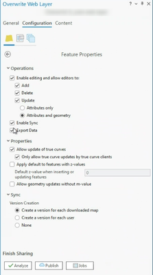

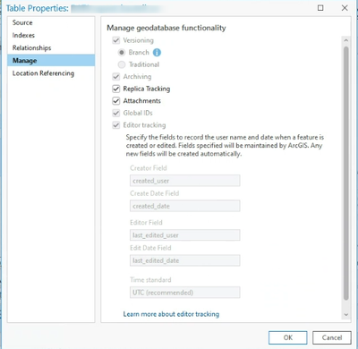

Just in case, I am providing a screenshot of the table properties:
....and a screenshot of the settings applied before publishing the feature service:
Do you know whether there is a limitation regarding the number of related tables? Is it possible to use a code which looks up every single table related to one feature service to verify whether it has an attachment ? If it is possible, how is it possible to access it?
