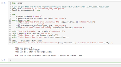

For everyone playing along at home; this issue is half-fixed (at ArcGIS Pro 3.1.0). You can now use JSONToFeatures_conversion, but you still cannot ListFeatureClasses() within the memory workspace.
I'll update the sample to some accessible data:
https://d2ad6b4ur7yvpq.cloudfront.net/naturalearth-3.3.0/ne_110m_lakes.geojson
import arcpy
# you can grab this data from here https://d2ad6b4ur7yvpq.cloudfront.net/naturalearth-3.3.0/ne_110m_lakes.geojson
json_input = r"YOUR_PATH_HERE\ne_110m_lakes.geojson"
arcpy.env.overwriteOutput = True
try:
    arcpy.env.workspace = "memory"
    arcpy.JSONToFeatures_conversion(json_input, "json_output")
except Exception as e:
    print(f"There's this 000206 Error when running the {arcpy.env.workspace} workspace:\n\n{e}")
    arcpy.env.workspace = "in_memory"
    print(f"But it seems to work fine running the {arcpy.env.workspace} workspace")
print(f"\n\tThis item exists: {arcpy.Exists('json_output')}")
json_in_memory = arcpy.Describe("json_output")
print(f"\tThis item is a: {json_in_memory.dataType}")
print(f"\tThis item is located at: {json_in_memory.catalogPath}")
list_fc = arcpy.ListFeatureClasses()
print(f"\n\tBut, when we check our current workspace {arcpy.env.workspace}, it returns no feature classes {list_fc}")
