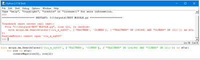

Hi All,
I have to make about 17 to 20 maps for a given location ranging from soils, topographic, wetlands, etc. I have to make these maps for about 145 different locations. So in total i will be making  about 2500 maps.
I have worked extensively with data driven pages and find it works great when the location varies but the layer stays the same, e.g. the wetland layer maps for all fields. I think of this as horizontal results.
I have also made a scrip that will output all the maps for a give location. It will create the soil, topographic, wetland, and otherwise maps for a given location. I think of this as vertical results.

Is there anyway to intergrate both a vertical and horizonal result? Selecting the tracts i need maps for and iterating through making maps for each selected tract?
Thanks
Tags (3)
EvanSweeney
Just an FYI, i found the easiest solution was to forgo the variables option and just create an SQL for my search parameters. i.e.
SQL =  "TRACTNBR IN (1234) AND CLUNBR IN ( 12)",
       "TRACTNBR IN (6789) AND CLUNBR IN ( 4,5,6,14,20)",
       "TRACTNBR IN (3456) AND CLUNBR IN ( 1)",]
##  Run for loop through each SQL statement  ##
for SQL in SQL:
         MAKE ALL THE MAPS!
It works pretty well until I run into a new problem that ill be posing to those who know better. The code gets hung up on Fields that dont exist (i.e. "TRACTNBR IN (1234) AND CLUNBR IN (17)" is the 250th loop in the code. The code stalls and eventually comes out with "RESTART: SHELL". I know i can go through and remove the offending the SQL, but i would rather add in something to help skip those errors. Ill likely be translating this for other teams to use so i dont want to bother pulling out bad fld numbers.
7 Replies
by Anonymous User
Not applicable
If I understand your need correctly, how about getting a list of tracts and then iterating over it?
Convert your script into a function so you can pass dynamic variables into it and reassign the variables as needed.
def createMaps(tract):
    Tract = tract
    .... # rest of your code
whereclause = 'if you need one to choose specfic tracts'
createMaps(x[0]) for x in arcpy.da.SearchCursor(yourfc, 'tractfield', whereclause)
EvanSweeney
Hi Jeff, I'm not much of a coder. Actually, I'm not a coder at all. I'm a conservationist. But I have tried to incorporate this code as indicated above and keep getting a syntax error on the 'for'.
I think this might be the solution i am looking for, i just dont know how to incorporate it.
by Anonymous User
Not applicable
No worries.  I didn't want to copy/ paste the whole code again but give this a try.  You might need to check the indents and make sure that they are correct since they get moved when the code copied/pasted from here without it being formatted. I see you also need/passed a second field, clu number so I provided the long form of the iteration to show passing the two values (check out lines 22 & 23). Hi from Wyoming the state, hope this helps.

EvanSweeney
Hi From NY,
That is closer. I keep getting a runtime error "RuntimeError: cannot open 'clu_layer"
For this forum, this wasn't the actual layer name, but the correct layer name still comes up with the error.
by Anonymous User
Not applicable
There are a few ways to solve that-  You can use arcmap (copy from the location at the top of the catalog) /pro (click on the fc in the catalog and look for the Copy Path in the menu ribbon) to copy the path of the featureclass that you want and use the path, assign it to a variable and use the variable, or you can use arcpy.env.workspace and pass the fc name.
clu_layer = r'path to the fc'
with arcpy.da.SearchCursor(clu_layer, [fields]...)
# or
with arcpy.da.SearchCursor(r'path to the fc', [fields]...)
# or using the workspace
arcpy.env.workspace = your directory or geodatabase containing the fc
with arcpy.da.SearchCursor('fcname in quotes', [fields]...)
EvanSweeney
Tried all three. Still getting the same error of not being able to open. But it's8:30 pm here so i think i have put in a solid 14 hour day. Thanks Jeff. Ill try again on monday.
EvanSweeney
for SQL in SQL:
         MAKE ALL THE MAPS!
