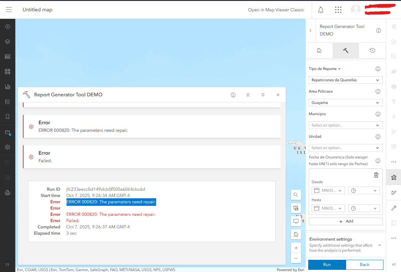

Hi all! I developed a python toolbox for ArcGIS Pro (.pyt) which contains a tool that will generate one of three reports. The tool is supposed to perform queries, process the queried data and finally generate the report selected by the user. This tool has several optional parameters that can be selected by the user but only one required parameter - Report Type.
When I run this tool in ArcGIS pro, all three possible reports are generated successfully, and the tool returns the path to the generated file as output, no problems there.

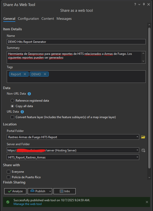

My issues arise once I publish this tool as a Geoprocessing Service. To publish the tool, I right click on one of the successful runs from the history tab, and select Share As > Share Web Tool. I fill out the relevant information, analyze then publish.

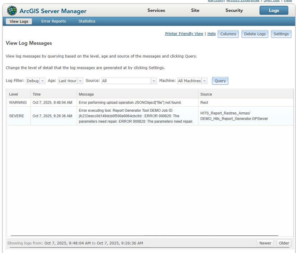

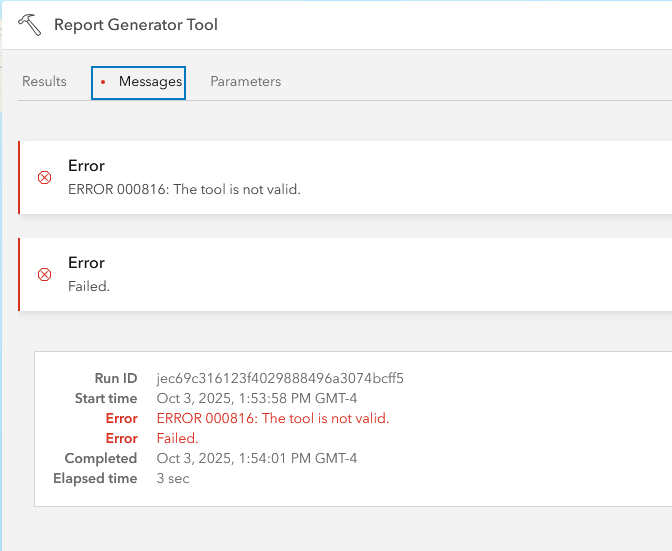

The tool gets published successfully. Once I try to execute the published tool (In my case, I'm trying it from the map viewer) I'm getting an error message saying "ERROR 000820: The parameters need repair." -  which is weird because the tool was ran in ArcGIS Pro, then published, so I'd think if there were any problems with the parameters, it should have raise errors prior to this point. Server Manager logs are not helpful either.
Originally I tried publishing this tool from ArcGIS Pro 3.5.2. When I did I got the error message "The tool Is not valid." I asked around the office and a coworker mentioned I should try publishing the tool from an earlier version, since the version of ArcGIS Enterprise where the tool being published to is 11.3. I started getting the "Parameter needs repair" message when I downgraded and published from ArcGIS Pro 3.4.2, and when downgraded and published again from ArcGIS Pro 3.3.7.
Finally and worth mentinong, this script makes use of the python-docx library, which I installed both in my local machine AND in the server where the tool gets published to. (Clone python environment, activate cloned environment, pip install python-docx)
Attached to this post I include a shortened version of the tool I'm trying to use once published. I have omitted all queries normally performed by this tool and have focused the code to just generate the report(s).
Any information that may help me troubleshoot this issue is greatly appreciated, thanks!

HaydenWelch
MVP Regular Contributor
I always have this issue when I dynamically load in tools locally. I write my PYT files to import the tool classes from seperate files and when the parameter code changes, the tool breaks in this exact same way.
Issue is caused by Arc caching the parameter layout on load. If you have modified your parameters, or if your getParameterInfo function is somehow changing during execution on the server it would cause this.
Have you tried removing all the parameters and running the tool? Just early return in the execute function with some message to see that changes are being loaded properly. Then make sure the cache is cleared on the server (restart the service, or manually clear the cache).
RViruet
Hello, thank you for your quick reply and suggestion! I have published a new tool with the following source code. I have removed all parameters except the output parameter and made the output a simple string. After publishing the geoprocessing tool I have restarted the server (Now using a single machine installation to do my tests) in order to clear the cache as suggested. I'm still having the same issue where once published and executed, I get the error saying that the parameter needs repair 🫠

That's incredibly odd. Especially since the parameter model should be rebuilt when the toolbox/tool is reloaded. The getParameterInfo method is run on each tool open. That function is used to generate a tool.content json file that maintains the tool parameters and relationships. The Parameters Need Repair error is raised whenever that tool.content file does not match the parameters that the tool class expects.
A really hacky workaround would be to rename the tool class to something like ReportGeneratorTool_r2 so a new cache is created with a separate model file
Here's an example of the structure of a model tool that lives in a .atbx:
The model.content files have the parameters and their names, the .model is just a file that contains the node relations and flow.
RViruet
Hi, thanks again for the prompt response! I'm going to give your suggestion s shot, and will get back you you.
BTW: my tool is included inside a python toolbox (.pyt) file and not the toolbox file (.atbx) - just thought I'd mention it.
EDIT:
No dice.
Thanks for all your help still 🙂
HaydenWelch
That's incredibly odd...I mostly use my pyt files in ArcPro so the server side stuff escapes me. That error is pretty clear that it's a mismatch in expected vs received parameters from the tool, so the fact that even with no parameters it's failing is interesting.
And I know you're using a pyt toolbox, I just wanted to show how a pyt is loaded into Arc, an atbx includes all the files while a pyt is just the definitions and the other data is loaded in on initialization and cached either in the web session or in an aprx/zip directory depending on where it's run from.
I will try and give this another once over tomorrow and write you up a minimal working example to test to see if it's something with your server configuration or the code itself.
RViruet
Update to this issue: I tried publishing the base example from another PC and it works. I think the dependency I added on my cloned environment was to blame for all the issues I experienced.
SerjStol
Did you try to navigate to the ArcGIS Server arcgisinputs (i think) folder where the published GP Service files are placed and inspect the pyt file there? When you publish there are some funky stuff that happen to the variables and parameters that may need guarding against.
