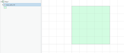

got it. but
import arcpy
array_polygon = arcpy.Array([arcpy.Point(1000.0, 2000.0, 50.0),
                              arcpy.Point(1500.0, 2000.0, 50.0),
                              arcpy.Point(1500.0, 2500.0, 50.0),
                              arcpy.Point(1000.0, 2500.0, 50.0),
                              arcpy.Point(1000.0, 2000.0, 50.0)])  # Closing the polygon
polygon = arcpy.Polygon(array_polygon)  # polygon object
out_fc = r"C:\arcpro_npg\Project_npg\npgeom.gdb\copy_poly_tst"
arcpy.CopyFeatures_management([polygon], out_fc)
seems to work as @XanderBakker suggested back in the day
