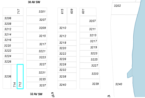

Below is a picture of the layer that the parcel to be copied is selected from. I have done numerous tests, each one selecting a different parcel.

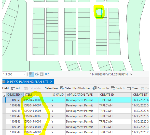

Below is a picture of the feature class where the shapes are copied to. All of the records in the attribute table have the same parcel location (even though I selected different parcels above).
