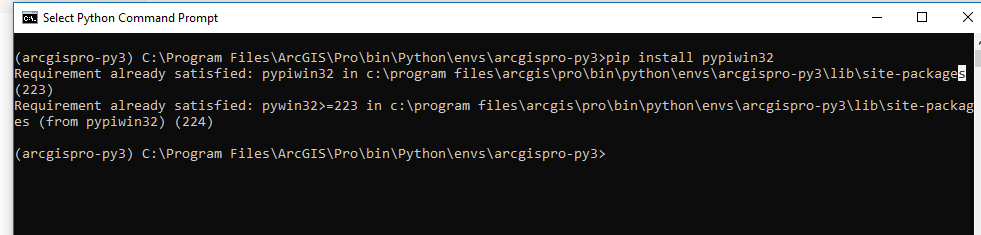

I want to use the pypiwin32 module in my python script.
I typed cmd into cortana search and used the python cmd. I typed pip install pypiwin32. The screen shot below shows that it's already installed.
Now when I try to import pypiwin32 in ArcPro, Juptyer, IDLE it says it doesn't exists.
I did the same with xlsxwriter module and same results. What am I doing wrong here??

I had IT run python cmd as admin. I don't have admin rights to my computer.
Also when i try to import pywin32 into my script it says that there's no module installed.
When I do the conda list. It says pypiwin32 is there  ?  Idunno if that helps anything.
