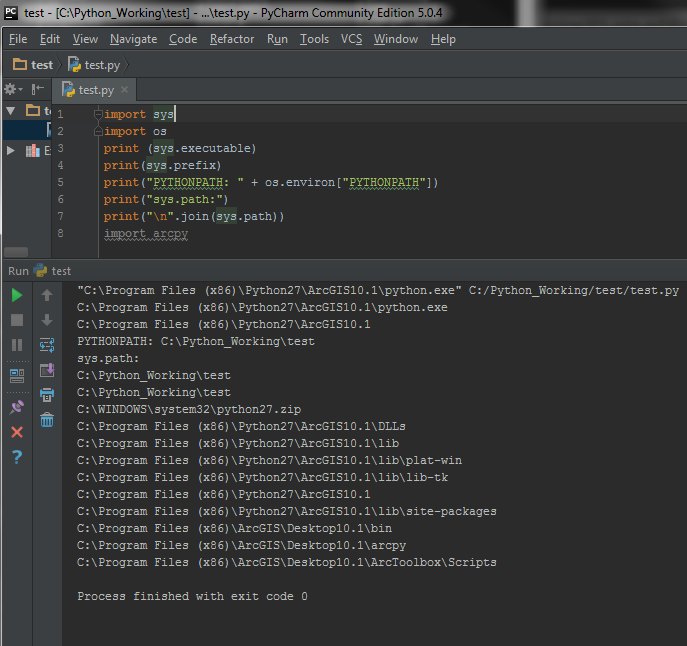

So, I recently got a new machine and I am having some frustration importing arcpy. It works fine in PyCharm but does not work when run from the command line.

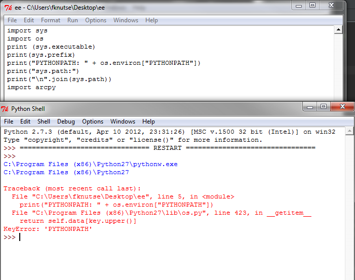

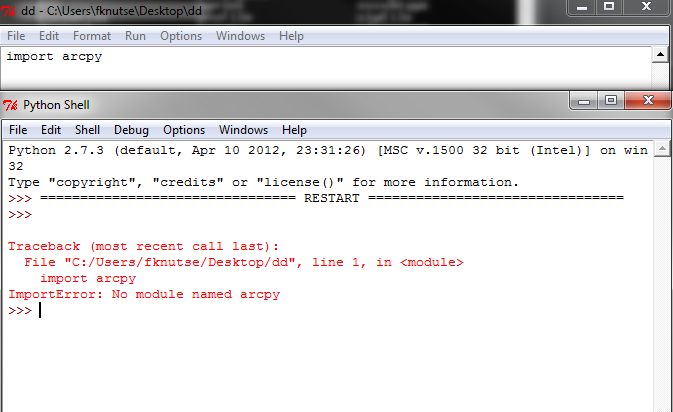

An import test in IDLE:

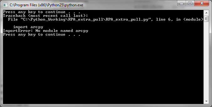

From the command line:
IDLE is pointing to the wrong install of python:
PyCharm is pointing to the right location which I set:

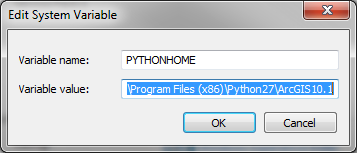

I have set the PYTHONHOME to the ArcGIS location:
C:\Program Files (x86)\Python27\ArcGIS10.1 but this makes python not work at all in the cmd.

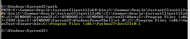

I have also SET PATH=%PATH%;C:\Program Files (x86)\Python27\ArcGIS10.1 (which I recall fixing this problem in the past); however, it is now also not doing the trick.

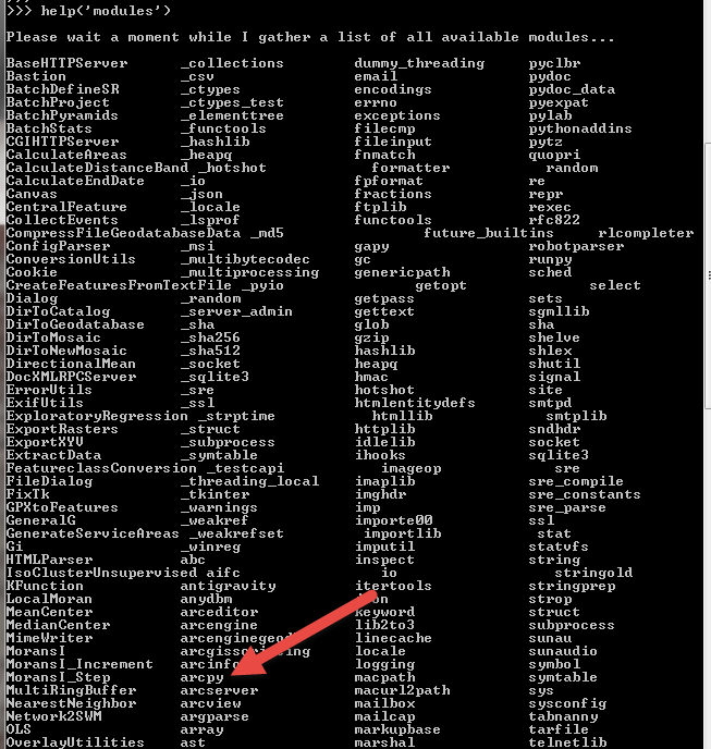

I can import arcpy using the python interpreter in the command line:
and it is in the module list:
