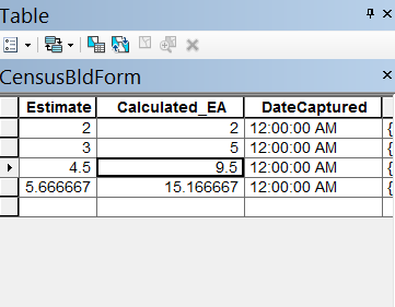

My python script calculates only the value of the immediate previous record instead of calculating the values of all preceding records before that particular record. The example (the image) below is the undesired output;
While the image below here is what i want to achieve;
This is my python script i used;
import arcpy
from arcpy import da
CensusBldForm = "CensusBldForm"
Calculated_EA1=0
with arcpy.da.UpdateCursor(CensusBldForm, ["OBJECTID", "EstimatedPopulationinEA", "Calculated_EA"]) as cursor:
     for row in cursor:
          Calculated_EA2 = row[1]
          row[2] = (Calculated_EA1 + Calculated_EA2)
          Calculated_EA1 = Calculated_EA2
          cursor.updateRow(row)
Kindly assist me with the above please.

you want the cumulative sum, your line 09 is only swapping the two values, I think if you leave it out, ...EA1 should cumulate correctly...but check a few first

I think this is a little simpler.
I put the field list in a variable to keep the code block skinny (easier to read)
import arcpy
vsum = 0
flds = ["OBJECTID", "EstimatedPopulationinEA", "Calculated_EA"]
with arcpy.da.UpdateCursor(CensusBldForm, flds) as cursor:
    for row in cursor:
          vsum = vsum + row[1]
          # a fancy way of the same thing follows
          # vsum += row[1]
          row[2] = vsum

yup... that is the cumulative sum

I also want to add a constraint whereby if the sum of the population values in the rows becomes 500, the next row's value would start from zero or the difference that makes the 500 from the previous row.
OLANIYAN OLAKUNLE  - I think this will do what you want with the threshold reset, if I am understanding your description correctly:
    for row in cursor:
          if vsum >= 500:
            vsum = vsum - 500
          row[2] = vsum
alculated_EA"]

I got the error below when i incorporated the lines of code you suggested;
TypeError: unsupported operand type(s) for +: 'float' and 'NoneType'
See my code;
CensusBldForm = "SCensusBldForm"
        vsum = 0
            for row in cursor:
              if vsum >= 500:
                  vsum = vsum - 500
                  row[2] = vsum
What do you think i'm doing wrong?
